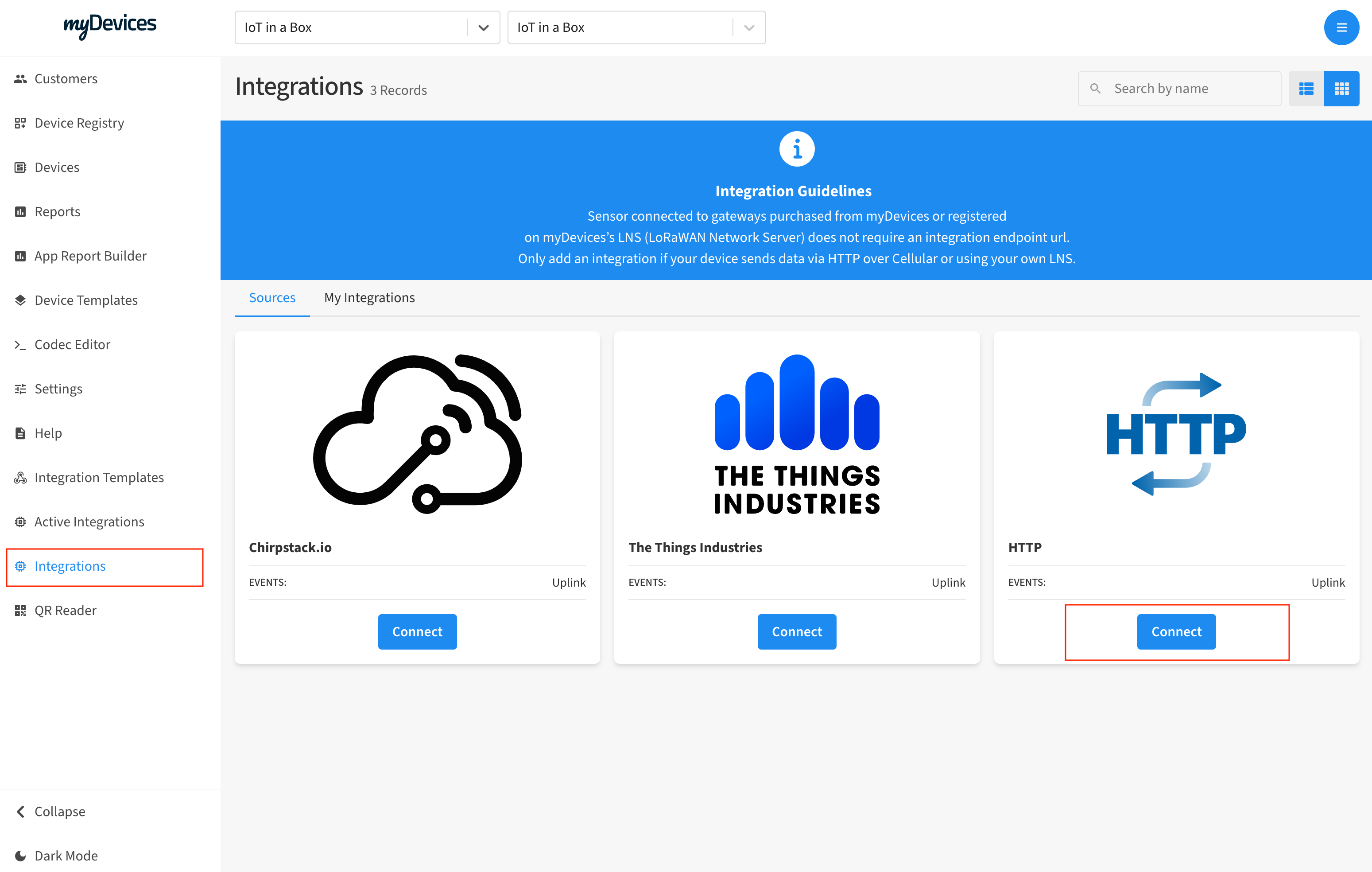

  1. Login to myDevices Console and navigate to Integrations.
  2. Select the Inbound integration: HTTP. inbound-integration-list
  3. Provide a name for the integration and click Generate.

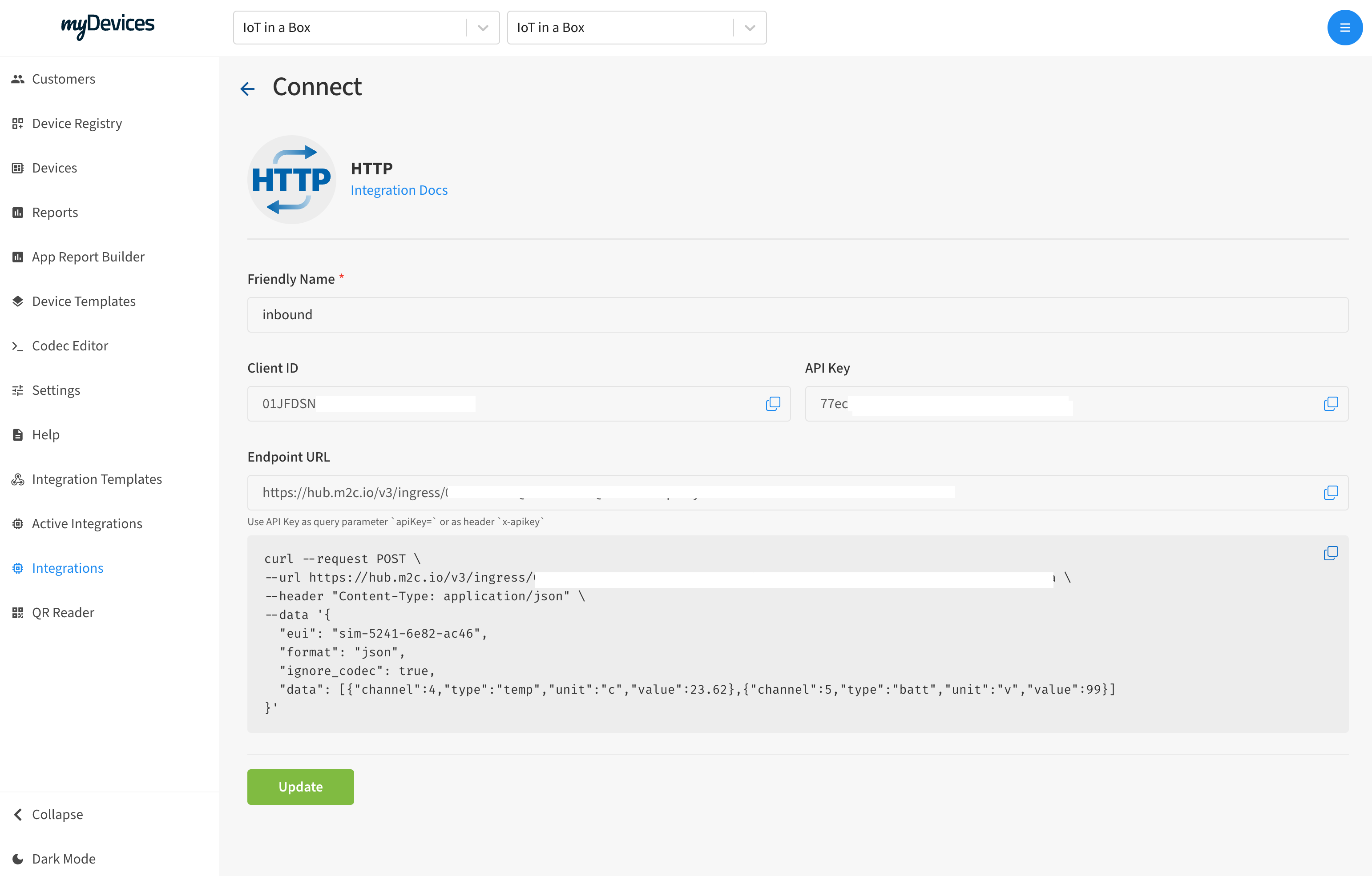

  4. Once the integration is created, copy the URL, Client ID and API Key to send data.
