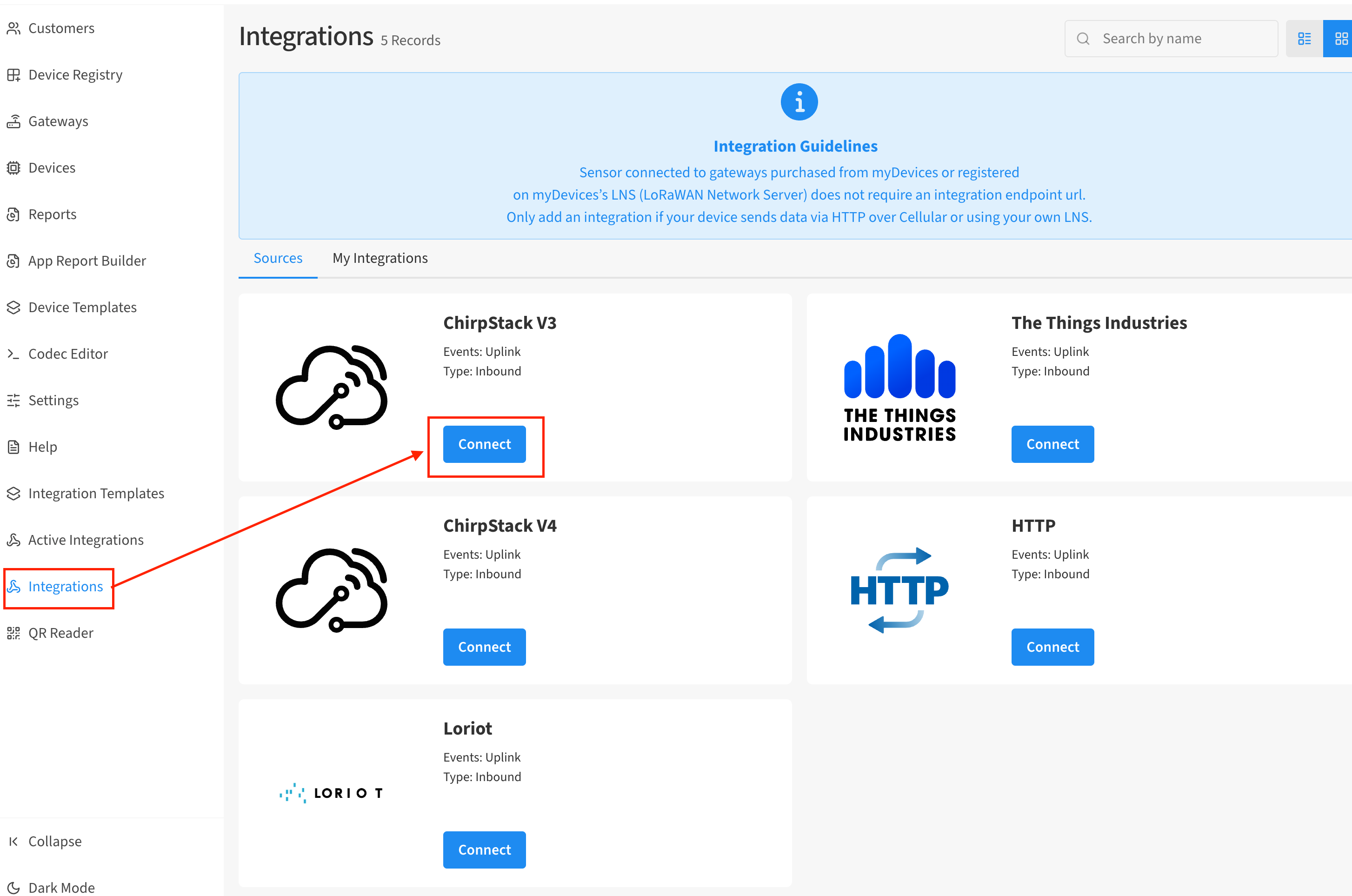

  1. Log in to the myDevices Console.
  2. Navigate to the Integrations section.
  3. Find ChirpStack V3 and click Connect.
