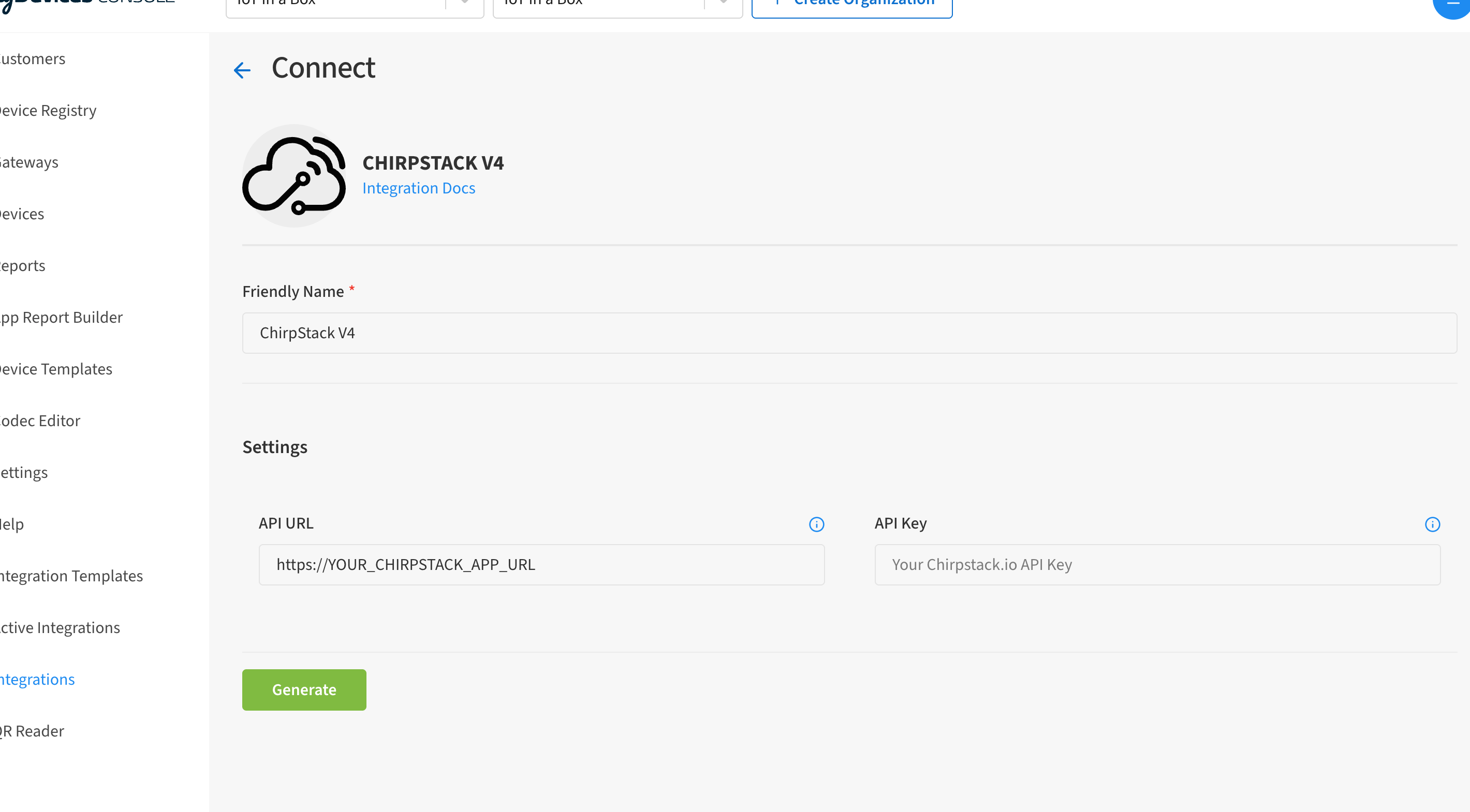

  4. Enter a name for your integration, your ChirpStack REST API Endpoint and API Key. This is needed for downlink support.
CSIOv4 Settings

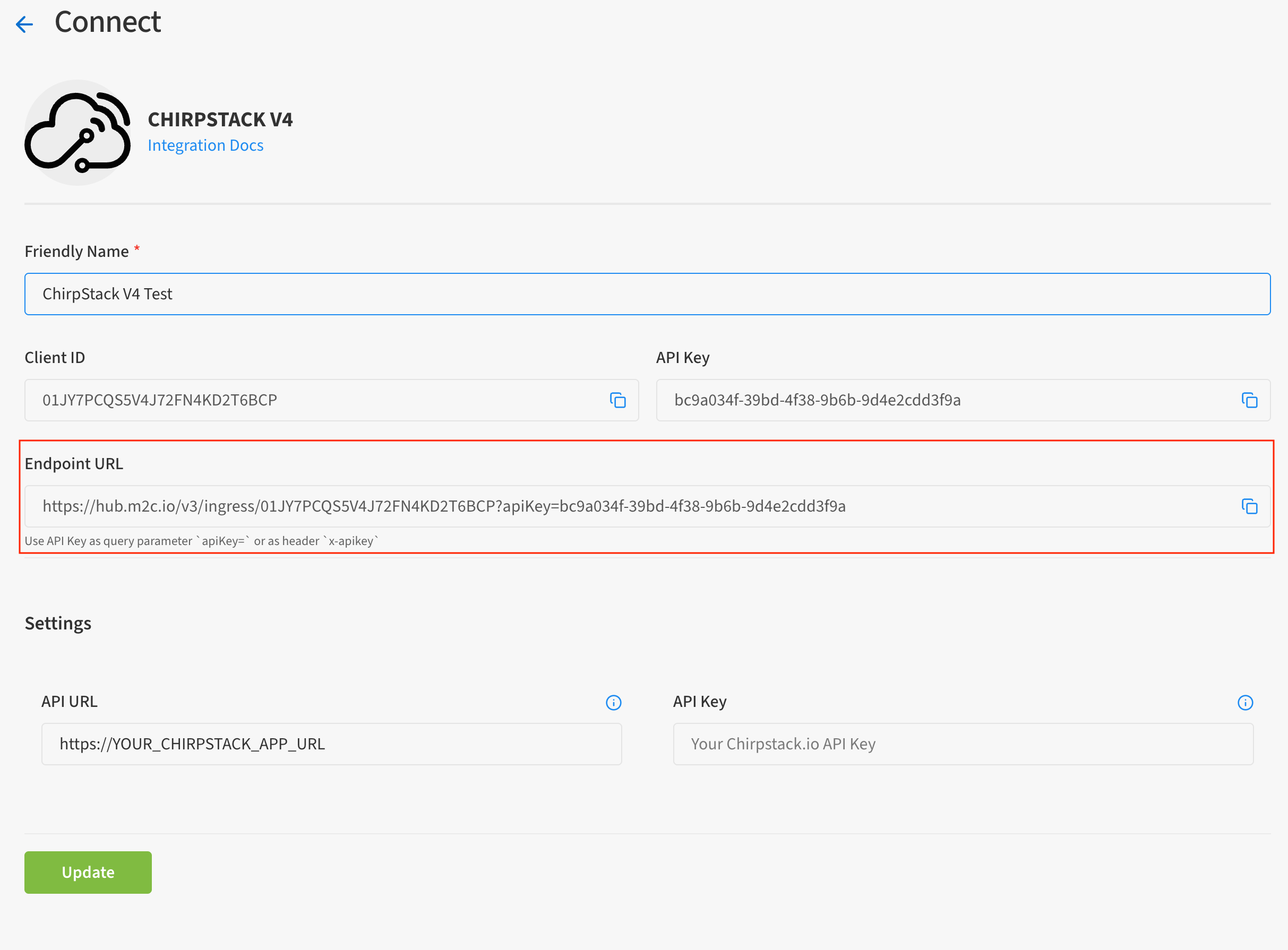

5. Click "Generate" and copy the **Endpoint URL**

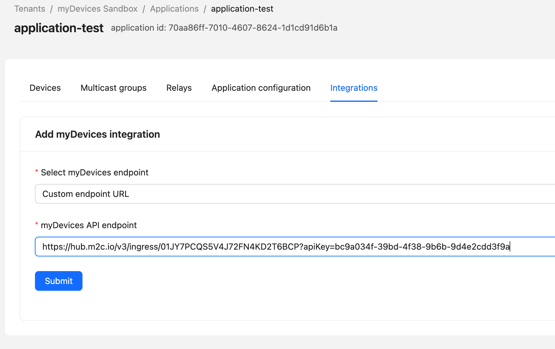

  1. Login to your Chirpstack Portal
  2. Select your Application and navigate to Integrations

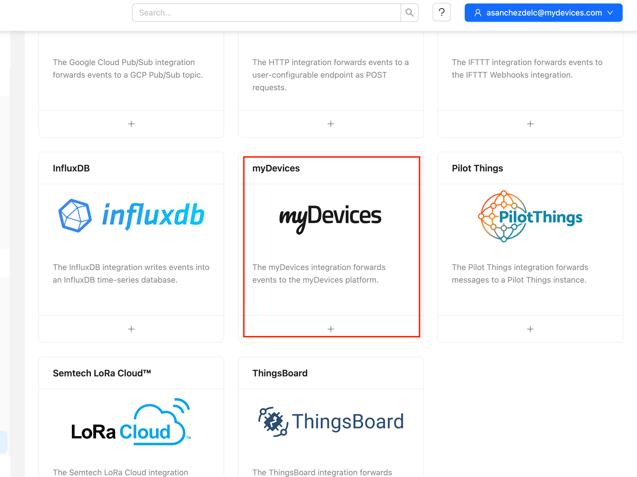

    myDevices CSIO
  3. Pick the Mydevices Integration and in the dropdown select "Custom Endpoint"
    myDevices Integrations
  4. Click "Submit".
